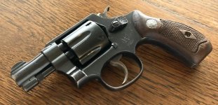

I picked this up a few years ago. After looking in the SCSW, I'm still confused on what to call it. The S/N puts it about 1956ish. I know the stocks are not even close to correct. Is this a Pre 30 or Pre 31?
Any help is appreciated.

No model number stamped. I believe it is on an I frame. S/N is 667745 which according to the SCSW puts it before the model number was designated. I am guessing it is probably 1956. The blued finish is in pretty good shape. I just wish it had the original stocks.
I believe the I frame was discontinued around 61 so it most likely is an I frame. I'm not an expert but believe the flat latch was only around in the pre 30 for a couple of years starting about that time. Again I'm not an expert.

In the Standard Catalog of S&W, 5th Edition, page 504 of the digital edition, Jim Carter (Hondo44) provides a description of the evolution of the I frame. Your gun falls into what he calls the "New I Frame" which is basically the last change to the I frame before it was eliminated by the J frame in 1961. So, your gun is a .32 Hand Ejector built on the New I Frame, Pre-Model 30.

Thanks. I am still going on my SCSW 3rd edition. The description regarding both the Pre 30 and Pre 31 are almost identical. I was more confused after looking it up, haha.

The 32 Hand Ejector model 1953 and model 30 has a round butt with 2, 3, or 4 inch barrel. The .32 Regulation Police model 1953 and model 31 has a square butt with 3 or 4 inch barrel.
