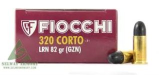

Ammo manufacturers don't help much either. 32 Corto (Short), 32 Short, 32 Short Colt are all confusing to many, not to mention 32 Short Rimfire. How many have heard about 32 Corto Short ammo? Short Colt is not identical to 32 S&W, but still help promote the "short" term. 32 Short Colt will, however, function fine in a S&W.

32 corto
32 corto is the oldest of the 32 revolver rounds, developed for the "Bulldog" revolvers. The 32 short Colt was based on that cartridge, there are many sellers claiming the 32 corto can be fired in a 32 long Colt chamber or possiby a short as well, but when I ask them if they have tried it, they decline. I have also asked them if would send some test rnds for me to try, no they will not. Has anyone tried shooting one in a Colt chambered gun?
