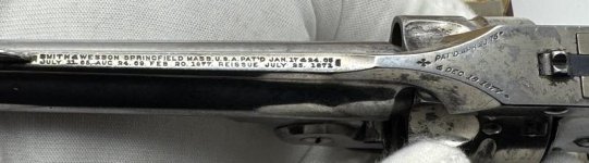

Wow very cool. I've never seen any advertisements talking about the Floral/Turkey stocks. Here's my nickel 32DA (S.1617). Were these only put on nickel finish guns?

I believe blue and nickel. I think for a short period of time and only one model. There was a big discussion a few years ago here on the Forum.
Do a search on "Turkey grips".
