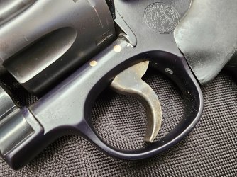

So just picked up a new 327PC ran about 100 rounds thru it and noticed some rubbing marks on the frame towards the rear of the cylinder, it appears the cylinder is rubbing on the frame during/while reloading. Have looked at countless other used 327's and none of them have this rubbing mark. Normal? Not normal? Im sending it in for service this week. Other than the frame being out of spec what would cause this?1000003078.jpg
It's possible that the yoke is slightly bent. If you're sending it in for this reason they'll check/adjust the alignment.
I have a 327 R8 with 11k rounds at the time this picture was taken. Just some scrapes at the material in the lug stop. And at the trigger stop where it hits the frame.
I would definitely have the factory check why the cylinder is hitting the frame there..
