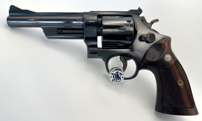

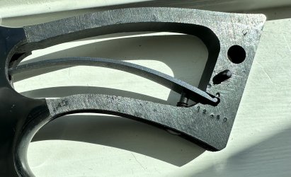

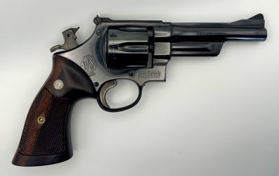

This looks like a Model of 1950 to me. However, it was re-worked by Smith & Wesson in December of 1950 based on the markings on the left grip frame. The same serial number starting with "0" appears on the frame, barrel, cylinder and crane. The ejector has a different serial number.
I don't know if the small diamond at the back, bottom corner has any significance. Same with the "46" up near the trigger guard.

I can add one tidbit to Hondo44's encyclopedia. My 1956 44 Magnum has "R-Bi" in a rounded corner square in the left grip frame. Roy Jinks told me it indicates a bright blue refinish job. Done in February 1976.
The diamond and the 12.50 are rework marks. I'm not sure but the 46 may be a stamp of the guy that did the work. I'll defer to the experts on that one. The cokes, while not original to the gun, are a real plus.
Based on that old thread, the diamond would be consistent with replacing the ejector.
I didn't think that the grips were original to the gun either but they fit perfectly. They also are in great shape 😎 Is it possible they came from the factory on this revolver or would any 357 Magnum Model of 1950 have either Magnas or diamond service grips?

Magnas were standard on the .357 Magnum, post WW II.
Since your gun has the 12.50 service date, its too early for cokes. They didn't appear until around 1955. I'm sure it probably shipped with magnas, but those cokes are still a big plus.
