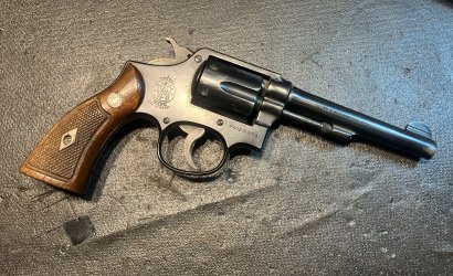

Does it matter that it doesn't have the speed hammer so I'm assuming long action? I'll post pics and full serial number tomorrow. Thanks all.

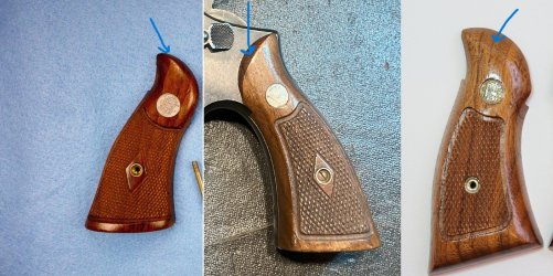

I'm not familiar with the term sharp shoulder Magna VS prewar magna.
Could someone post a side-by-side photo comparison of the two, please ?

Pre-war have sharp shoulders but don't look like post war. so the term differentiates early post war magnas and later magnas (exceptions exist I'm sure). I'll dig up some pics.
Left is pre-war, center is post but sharp shoulder and right non-sharp shoulder.

Pre-war have sharp shoulders but don't look like post war. so the term differentiates early post war magnas and later magnas. I'll did up some pics.
The sharp shoulder Magna style was used into the early 1950s. S&W should have kept it, seems to me to be more elegant. There are some differences between the pre-war and postwar sharp shoulder stocks. Pre-war, and some early postwar, SS stocks are fairly desirable and priced accordingly.
