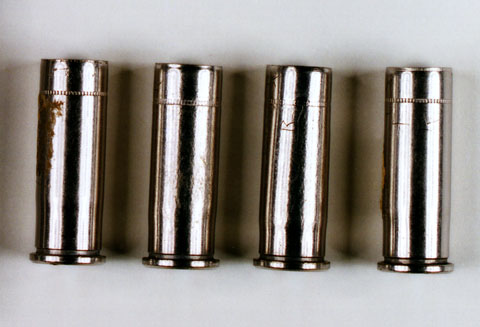

Below is a link to a photo of four empty .38 Special casings that were also fired in a converted "Victory" model .38 S&W.
http://www.jfkfiles.com/jfk/images/news/120310/FIG03_120310.jpg
You may recognize these as the four empty casings from the rounds fired by Lee Harvey Oswald into Officer J.D. Tippit on November 22, 1963, shortly after the assassination of JFK. Oswald's revolver began life as a .38 S&W "Victory" model revolver, sold to Britain in WW II under the Lend-Lease Program, and it had been converted to .38 Special some time after WW II.
These casings display the same bulge near the centre you pointed out in your photo, and this is the part that has puzzled me.
As you likely know, the shorter .38 S&W casing is .3855" in diameter at the neck, and gets gradually wider toward the base, where it is .3865" in diameter. With the .38 Special casing being a uniform .379" in diameter, and longer than the .38 S&W casing, I would imagine the reaming of the chamber only involved reaming that part of the chamber forward of the neck of the .38 S&W casing.
My question is, with the rear part of the converted chamber being .3855-.3865" on a uniform taper, why are the empty casings only bulged in the middle? Why do we not see an empty casing uniformly bulged right to the base (rim) of the casing? Was something added to the base of the chamber to stabilize the narrow .379" casing in the wider .3865" chamber? Is this why the .38 Special casings were difficult to extract after being fired in these Victory conversions?

The solid interior base of the .38 Special (and similar) cases extends somewhat forward of the rim. Therefore it does not expand diametrically upon firing. In my experience with firing .38 Special cartridges in the reamed .38 S&W chambers I have never seen a split case result. Longitudinally split cases do not create a hazard. I have experienced many longitudinal case splits in many different revolvers without incident. Circumferential splitting near the base just does not happen in handgun rounds, but under some conditions of excessive chamber headspace, it can occur with some bottlenecked rifle cases, especially those of the belted variety, after several reloadings. The case usually show signs of incipient head separation (in the form of a bright ring appearing) before it actually happens. Those case failures can be very bad.
