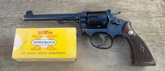

I'd never had one of these before (other than a Model 14-2), so when it popped up today, I had to take the plunge. Serial number 6282XX, which I think probably puts it around 1929-30. Yes, I know the stocks are wrong, but the price was about the same money as an ordinary M&P or Model 10 commands nowadays. My question is, as it may be in kind of a "no-man's land" insofar as that time frame is concerned, whether the silver medallion or plain convex top service stocks would be appropriate.
    20.7 KB
It probably shipped with silver medallion stocks, since it has the barrel shaped ejector rod end.
A letter should tell you for sure.
I guess my other question should be if by that time the serial numbers were being stamped in rather than written in pencil.
Actually, the shape of the extractor rod knob isn't particularly helpful in this case. That change was made on the .38 M&P in 1927. My guess would be that the stocks would be of the 1930s medallion style, but knowing the ship date might give you another clue.
As for the serialized stocks, that serial number is right on the cusp of the change to using die stamps instead of a pencil. At 6282XX, they were probably stamped.
Incidentally, the stocks shown in your photo are early postwar Magna (1946-1952). If they are as nice as they appear in the picture, they carry a bit of value in themselves.
Nice purchase!

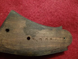

The number stamped into those stocks is 948 over 582, which I'd presume would be indicative of that gun's serial number being "S" prefixed.

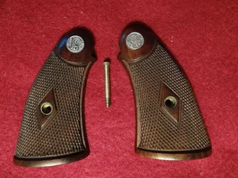

As for what I'll be replacing them with, I do have a nice set of unstamped silver medallion service stocks. I also have a set of faux pearl service stocks if I want to be a little more flamboyant.
Interesting. That revolver probably shipped in October 1947. Curiously, the stocks for S948427 also were separated from the original unit. They showed up on a K-22 Outdoorsman's.

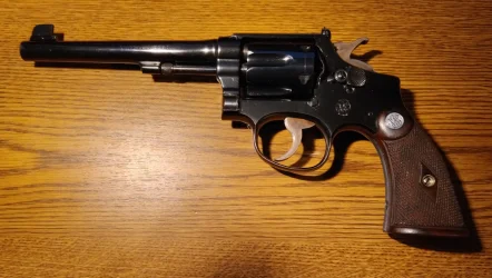

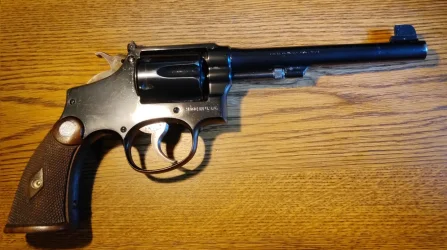

I recently picked this one up. The serial number is very close to yours, 628302. It was shipped in September, 1930. Number matching stocks, silver medallions.
Gorgeous example, certainly better than mine. Answers all my questions. Accordingly, I put on the silver medallion service stocks, which turn out to be ever so slightly undersized. Still, the gun looks far more "right" now.
