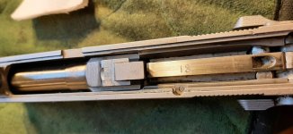

I just bought this gun from GB. I am told by the seller that the guy he bought it from worked at S&W. The gun appears unfired.
I have attached photos showing both the underneath of the slide and the barrel marked apparently by hand 18 or maybe 81.

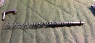

The other photo shows two recoil springs and the guide rod. As shown in prior photos the top of the barrel is marked .356TSW over Performance. Not sure what that means. Is this gun a R&D, a one off or a lunch bucket special.

Those two digits hand engraved in the barrel (& slide) are normal markings that the assemblers in the S&W Performance Center put on these finely hand fitted pistols.
All of the 3566 Limited's (I guess that's what you bought?? Need more info ;)) have their barrel stamped that way on the hood.
I don't know what's up with the double recoil spring setup? Either someone made their own "replacement recoil spring" (because the exact PN# for the factory recoil spring is unknown, though I've posted what will work in its place) or it was a early/later mod by the factory?

PS: Can you measure the exact diameter of your guide rod? As far is I know the 3566's only had a single recoil spring on a .290" dia guide rod. Guide rods that were designed to work with double/nested recoil springs (like the 4013TSW etc.) had a skinnier guide rod that was .237" in dia.
The factory barrels are closely fitted but should slide out at the proper angle.
We don't know what you have exactly because to haven't shown up the whole pistol & you piggy-backed on this thread of a unknown model. S&W made several variations of 356TSW pistols. You need to post more pics & details if you want the proper answers.

Guide rod is .236" in diameter.
