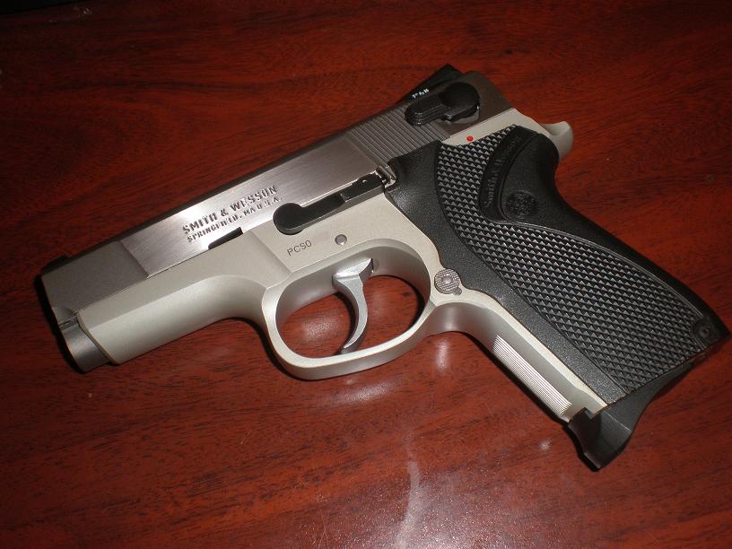

Secondly don't overlook the various models from the Performance Center; pistols like the Shorty Forty (technically a 4006). There are a host of others that come out of the PC that would serve equally well. Here is an example, this may be considered a mid-sized pistol:
