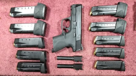

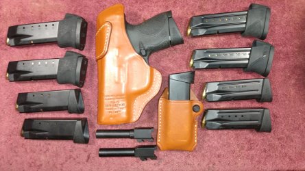

I bought a M&P 40c back when they first hit the shelves. I bought a factory 9mm (Compact) barrel a few years later with a few factory 9mm mags.
I have shot uncounted rounds through this conversion without a hiccup and use it sometimes for CCW.
