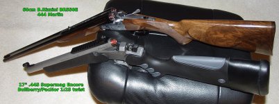

Behind 31 gr. IMR4227 that bullet goes 1822 fps out of a 12" .445 Supermag Encore and 1913 fps out of the 17" barrel.
I get 2145 fps out of the 22" 444 using a 280 gr. WFNGC and 41 gr. H4198.

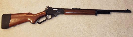

The 444 as it looks now with peep sight, happy trigger, and better butt-pad after a complete rebuild.

I'll run them in the Redhawk and the Encore both of which have thick, hard, barrels but would hesitate to run them in the double with it's thinner barrels especially near the muzzle.
