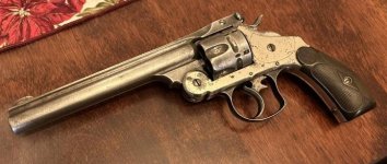

I'm in negotiation with a gentleman over a pistol purported to be in .44 Russian. From the pics he sent me, I can't see the step in the chambers and it looks like it's bored straight through. Can you safely fire .44 Russian out of a pistol chambered for .44 S&W? Final question, is .44 S&W the same as .44 American?

It's my understanding the .44 S&W was later referred to as the .44 American to differentiate between the original .44 chambering with heel type bullets. The .44 Russian had the cartridge case increased in diameter to eliminate the heel type bullet and go to an inside lubricated style.
The cartridge case of the .44 American would be a sloppy fit in a .44 Russian. Conversely, trying to fit a .44 Russian into a chamber designed for the .44 S&W American would be like trying to stick a .22 Winchester Magnum into a revolver chambered for .22 Long Rifle, it won't fit.
The revolver in the photos is a model 3 New Navy Double Action, which was most commonly chambered in .44 Russian but also in .44-40 and .38-40.
The seller needs to check if a .44-40 (or .44 Special?) chambers fully, or the chamber length from the rear face to the shoulder seen in photo 2. If it is 0.91", .44 Russian.
I suppose someone could have also reamed it to accept .44 American but that would have been unusual.
44 Russian
It’s a 44 Russian. I can see the case stop in the upper cylinder chamber and slightly in the lower chamber. For whatever reason they are worn but still visible so it’s a 44 Russian.
