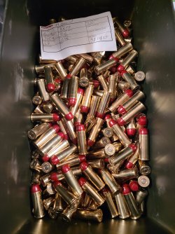

Finished up the run today. Somehow I ended up with the exact number of primed cases to bullets. Can't argue with that! Still had a little powder left as well. I honestly have no idea how many rounds I loaded as I had primed cases. The bullets and cases were both supposed to be 500, but Acme (bullets) and CDVS (primed cases) always ship more.
When done the run filled a 50 cal can about half way. That ought to hold me for a while!
