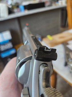

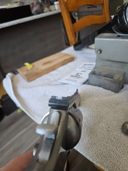

Successful, so I did my 610 no dash too.
