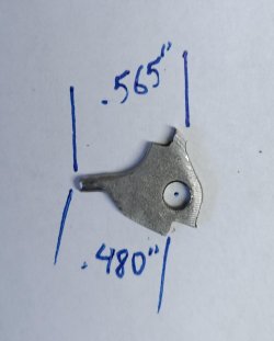

I see a lot of "fits multiple models" when shopping for one, but is there a guide to exactly which models a particular part fits? So far, it seems like there are more different hammer noses than there are S&W models!
Is there a nose without spring that will fit/work in the (1970s) 67-1?hammer nose.jpg
Jack First has the correct hammer nose for your model 67. While this model nose doesn't require a hammer nose spring, you can easily cut a slot for one if desired.
