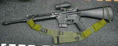

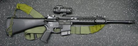

I built one for deer and hog hunting. ASC Mags are hit or miss. CProd mags are the best and mine have been reliable. Magazines and feed ramps are the key.
Built the upper and slapped it onto a stock S&W M&P15 lower with a heavy hammer spring installed.
