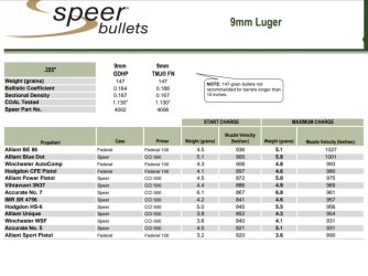

Anyone in here have experience loading 9mm with heavy hardcast?
I want to load 147 or heavier hardcast with a wide flat nose keith style bullet.
But I don't find bullets or load data like that for 9mm. So I'm wondering if anyone knows of source for bullets that meet that criteria. Or if anyone has had success loading a bullet designed for 38/357 that could be resized for 9mm?
I know Buffalo bore and underwood both have a load very similar to what i am trying to achieve. But i don't know if they are sourcing their bullets from a maker that has them available for retail, or of their bullet designs are proprietary.detail_388_24LMedium.png

Acme, Summit, and Missouri all have a good TC 147 grain hardcast. I loaded some up using Silhouette. This is max standard pressure of the Hodgdon website:
147gr Summit FP
4.6gr Silhouette, 1.145" COAL, SPP
4" Glock 19: 956fps
+P is 4.9 grains. I haven't tried that but it's supposed to add about another 100 fps. I just used mixed range brass. No feeding issues whatsoever in my Glocks. Haven't tried them in anything else yet. Silhouette does a good job for "energetic" short pistol cases. Works a lot like Power Pistol.
