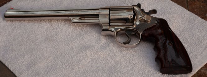

My 29-3 has an unpinned barrel. Does this affect the performance of the revolver? accuracy etc? Is it possibles to change it to be a pinned barrel and if so is it worth bothering?
Second question - I usually shoot .44 spl out of the 29 and it's very accurate. If I shoot mags out of it - say federal 180gr factory ammo, the top strap starts to work its way so that it is lifting up off of the barrel. It has not really affected the gun but it's kind of annoying. I keep my screwdriver handy so I can seat it back down. Would putting loctite on the screw be inadvisable?
Thanks - Mike

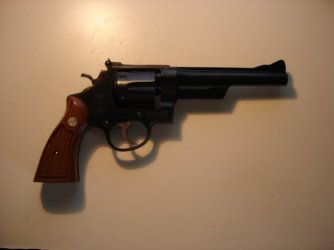

When you say the top strap is getting loose, are you referring to the rear sight? If so, I'd remove it, clean the screw and hole and use either purple loktite or clear nail polish and reassemble. The 29-3 didn't come with a pinned barrel unless you got a transition model. Your barrel shouldn't come loose.
Here's my 4" 29-3. Good luck.

Beautiful 29. I replaced the Goncalo alves with a set of custom walnut carved grips as the original grips such as yours tore my hands up when I shot mags.
