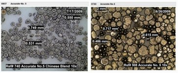

#5 has had different manufactures. See the many photos of #5 National Center for Forensic Science
The size & shape of powder has an effect on burn rate. Powder companys blend powder all the time. A extra fast batch will get blended with a slower batch.
A blended lot can still be as much as +/-5% difference in burn rate, between finished lots.

Just look at the pictures posted. The granules are random sizes of flattened ball. Its very possible that what OP took to be two different powders was consistent with expected granule variations within a given lot.
I have gone through 16 + lbs of WC820. It has on occasion looked as though it had floor sweepings in with it. It was marketed as AA9 equivalent and I have shot it as such. At no point does the odd extruded powder granule get culled, just shot with the rest. AFAIK, AA5 has always been a canister powder.
