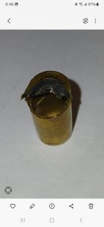

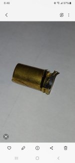

Ammo bad round??
Reman ammo from 2A warehouse.
That's crazy. I've run thousands of reman 9mm, 45acp and 300blk from 2A Warehouse. They've been a go to for cheap ammo for the last 4-5 years for me. Glad to see they are willing to pick up the cost of any repairs and refund the ammo without even waiting for CZ to diagnose.

Forgot to mention he checked the remaining ammo found some with dents in the brass.
So it kinds all makes sense, seems like the round was not seated fully.
He should take the rest of this ammo and try doing the plunk test before sending it back.
That way he knows for sure if it is ammo related, my guess it is.
