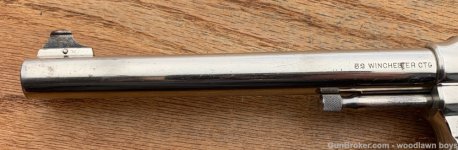

Here's a S&W revolver chambered for the .32-20 that shipped in March, 1904. Note the stamp on the barrel.
I used to own an early Marlin Model 336A chambered for the .32 Winchester Special and that's what it said on the barrel. Unfortunately, I traded it to a friend nearly 50 years ago and don't have a picture of it. But if you look at any Winchester or Marlin lever action rifle or carbine chambered for that round, it will have the word Special in the roll stamp.
