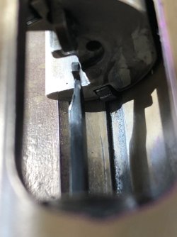

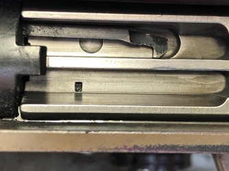

Another thing to check is the ejector which is easily bent out of alignment, also easily bent back in place. It needs to be as close as possible, without rubbing, to the bottom of the bolt and to the middle rib on the bottom of the bolt. If these fixes don’t produce 100% reliability, a new extractor might be needed, Volquartsen being the product of choice.

To continue with my previous post about ejector adjustment, I took a couple of pictures to illustrate.

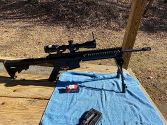

I bought my 15-22 shortly after they first came out. Never had any problems mentioned in OP post. Loading the magazines properly is important using the loading assist button loading one bullet at a time then release (don’t pull button all the way down and just drop bullets in.) Bullets should be staggered in it. I clean mine after every range trip. Not picky about ammo but CCI Mini Mag 40 grain round nose is the most accurate at fifty yards. Use a plastic or wooden pick to ensure bolt face is clean around the circular crevice. I also use the 10 round magazines instead of the 25 round as I shoot mine with a bipod. Have a Nikon P-22 scope with BDC reticle mounted. Great scope but Nikon does not make rifle scopes any longer.
