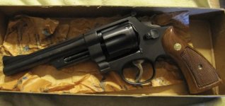

Gorgeous guns! I’ve got a N serial 28-2 that I’ve never shot it’s like new in box so I’ve been wanting to find a nice shooter. N frames fit my hands much better than Ks and I love the look of a shorter barrel big frame revolver

That is the worst fitting set of target stocks I have ever seen. Obviously from a different revolver. I think your M28 would have had Magna stocks originally. I have several N frames with factory target stocks, none are that bad.
Definitely from a different revolver I’m pretty sure this would’ve came with diamond magnas being from 64-65. I spoke with Don Furr and I am going to ship them out Monday to have him fix whatever he can on them.
