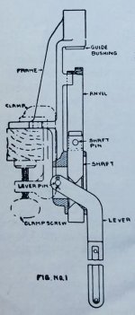

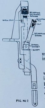

More info
I actually found some very early catalogs. Looks like mine is their first press that was applied for in about 1930.
See figure 2. I think you actually have to use a C clamp to bench mount it. Very early press but it's pretty solid. I'm going to fabricate some dies for it to load 32 cals.
The later press with bench clamp came out in about 1934.
Their prototype press was actually brass.
Murph

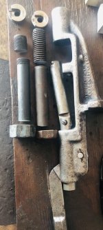

Fabricate
Well,
I doubt that I'll ever find parts for this antique press but I want to put it back to work. I decided to fabricate two plungers for now. One in 32 Auto and the other for 32 S&W. Those smaller calibers will apply a low load to the press so I'll start with that and see how it goes.
I used two grade 5 bolts, cut them to match the existing plunger. Then machined a slot to fit the press. I'll drill them out after the weld.
I'm gonna weld two modern cartridge holders onto the fabricated plungers.
I know I could have fabricated a universal shell holder but that's no fun!
Murph
