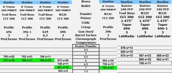

N32C "Tin Star" is supposed to fill the same role as Trail Boss but is a quite different powder from TB.
It burns slower and is quite a bit denser. (I don't know of a powder that is less dense than TB).
Here are a couple comparison loads I have made in 44 special:
