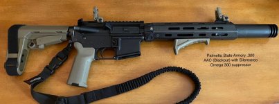

Completed my .300 AAC Pistol Build
Just finished up my "Christmas" build of a AR .300 AAC Blackout pistol. I took off the stock and buffer tube and installed a Magpul ASAP QD single point sling adapter on the receiver. I really struggled getting the castle nut loose because Palmetto State Armory really staked (actually double staked) the original plate to the castle nut. Finally got the castle nut loose and was able to save it and reinstall it with the Magpul ASAP. I did re-stake the nut, following Brownell's YouTube instructions. Then I installed my Silencerco Omega 300 suppressor. It was actually a very fast approval from the ATF...I submitted my Form 4 last Thursday and had my approval on Tuesday (that included a weekend and the MLK Day holiday). Anyway, here is my completed build. I have several red dot scopes if I decide to add one later. Enjoy!
