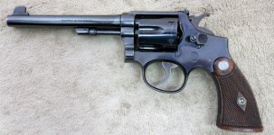

Before I got this job, I still lettered all my guns. Here is a "Plain Jane" Pre War .38 M&P. It is in it's original box. Would you get a letter on this?
I'll be back with my answer.

Thanks Lee. Sometimes we just don't know what we don't know.
