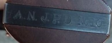

Have a pristine Colt Police Positive .38 (.38 New Police) SN: 385xxx (about 1939) with "B.S.D.& Tr. Co.15" stamped on the butt.
Any clue what this represents ?
Correction Fixed. It is BSD. SN comes out to a 1939 production year.

Wow. That's a candidate for "Most letters in a butt stamping". Can you post a photo so I can add it to my collection?
I haven't seen that one before, sorry.
Here is the previous winner, seven letters plus two digits, Colt DS 1931, unknown.

I would also think some railroad. There were and are many short-line railroads serving regional areas, and the letters were usually initials of cities or locations they served (CSD&R might be something like Cleveland, Sandusky, Detroit and Rochester) . Many were/are industrial freight haulers. There may be a website which lists past and present short-line railroads.
I think the "Tr Co." is for Trust Company, and the "15" is an inventory or rack number. Many banks had armed guards and curriers after the "Roaring 20's"

Someone had once suggested Boston Savings Depositor & Trust Co. but how many cities in the USA begin with a "B". Perhaps this calls for one of those big dollar Colt letters.

The way your picture shows it, the Tr Co could well be B.S.D. & Trust Company. Finding the B.S.D. part could be a chore, as very few (if any) financial institutions of that period contemporary with the gun still exist under their original name. A Colt letter (pricey) might (or, more likely, might not) help identify it. Lots of cities begin with B.

A factory letter might be productive, especially given the gun's nice condition. There is the possibility that the stamping is factory-applied. Colt did that much more frequently than S&W.
Look at the comparison I snipped together. Unfortunately, only the digit 1 is common to both. The "No. 11" is factory-lettered on a 1951 Official Police. Font, size, and strike pattern are very similar. Of course, these die sets were probably quite common.

I believe it's for Boston Safe Deposit & Trust Co.

The name as that has been used a number of times and there still is a small bank with that name but fairly new to the scene.
I think the one on the OP's revolver was probably more likely the West Coast based bank used by the railroads from the very late 1800's to just before WW2.
Here;s one link to a BSD&Tr in Ca early on.
#1214 - Boston Safe Deposit & Trust Co and California Southern RR Co - State Archives - Kansas Historical Society
Another one I found in a 1883 yearly report for the Atchison, Topeka, and Santa Fe R/R lists an entry ...

FWIW,,the marking looks like a Colt factory roll mark,,not an individually handstamped mark.
Colt would make up a die to do a number of guns on order for an organization if you wanted to pay the extra.
The 'weapon' or rack number was sometimes added aftermarket. Sometimes it was Colt impressed with the same die, the die being made with a replaceable character or characters insert so as to be able to change the #.
It was a common thing on roll dies to be able to mark the same bbl address on rifle bbls for example and be able to change the caliber marking insert.

Could be Boston Safe Deposit & Trust Co., an old line Boston banking firm that specialized in loaning large sums to utility, transportation, shipping firms. In the old days lots of cash on hand, no cyber cash.....

Including the dots or periods, they both have exactly 15 stamped characters.
