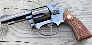

Yep. S/Ns 6xx (bottom)and 12xx(top). The very earliest ones had a "regular" thumbpiece
Well, no.
Despite some who disagree with me, yours is the 2nd style flat latch.
Yours is ⅜" tall and rounded on the right side, as are both of delcrossv's.
My serial number 99, and a friend's number 101, have a flat latch that's only ¼" tall and squared on the right side. They, in my humble opinion, were the 1st style flat latch. They are the only two of that style I've seen.
The images clearly show a difference in the latch's material difference from the screw to the edge of the latch and the squared right side.
Hope this helps.

Hi Bob, so it's shorter? (front to back)? Looks that way. On mine the blue one seems narrower than the nickel one- but I'd have to pull them out to verify.

So which version is this on 12340 from 1952? Thanks again.

I have 5 Babies, # 765 came from the original owner and he bought it new, the latch is wedged forward with a high projection on the left end at least 1/8 "high. when you look at it, it looks like the rest of the ones above except that high projection on the left end. When you look down on the top, the right end is 1/8"thick and it rises to 1/4" thick on the left end. Two others have the latch like the ones above. Can't look at the other two I have as the are not here.

46042 has the later trigger guard shape and is not a "Baby". Photo is there just to show the thumbpiece shape.
Richard, Danny, et al,
Any study of S&W revolvers evolves as previously unknown examples surface. That becomes more and more clear to me as I study the evolution of the carbon steel Chiefs Special/Model 36 and its derivatives (Airweight/Model 37, Bodyguard Airweight/Model 38 and Model 49, which all used the same serial number series as the carbon steel Chiefs through the early '80s).
The earliest Chiefs had the standard S&W thumb piece, but we don't know how many wore that thumb piece before the first flat latches appeared.
Hondo44's list does not include the one I've identified as the 1st style flat latch. I've only seen two (on serial numbers 99 and 101), but I would imagine there must be at least a few others.
Danny's Baby has the 2nd style, which, like the 1st, has 11 lands (or ridges).
"Baby" Chiefs Specials ran from serial number 1 to 45963. At only 79 numbers higher, Richard's 46042 is the first known "Model of 1953" Chiefs Special. It has the 3rd style flat latch, with only 10 lands and a slight ski ramp shape. That third style flat latch began around serial number 35xxx in the early fall of '53 and lasted to between serial number 51xxx and 55xxx in late '54 or early '55.
As far as we know, there were no "transitional" Chiefs with a larger oval trigger guard and a short grip handle.
My serial number 47475 has an oddball 4th style flat latch that might have been on one-off design with only 7 lands. I have not seen another like it. That Chiefs Special went to S&W's sales manager, Mr. H.O. Austin, "for demonstration purposes."
The next, 5th style flat latch, went back to 11 lands and has a steeper ski ramp. There was one more that began, perhaps, in 1959 after Model numbers began. It also has 11 lands, and it had an even steeper ski ramp. It lasted till S&W replaced the flat latch with the original style thump piece in about 1966.
