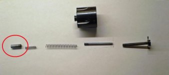

There is only one missing part, the ejector rod that screws into the shaft of the ejector star is missing, so the revolver does not function. I believe I can get the part made, since you just cannot find parts for a Perfected DA. The ejector assembly is different than a 38 DA.

Is the circled part what you need ?
Yes, it has a small spring that goes inside that rod keeps the center pin protruding through the ejector star. It is the same external dimensions as the 38 DA rod, but different thread diameter, plus the DA rod is solid, not hollow. Sam, who has done some great work making ejector rod knobs for 1896 and 1899 HEs has agreed to try to make a replacement. The bigger problem is re-bending the quill, so the action closes properly. I am dealing with a big upside in value to get this little gem working again, plus saving one of the nicest 38 Perfected revolvers I have ever seen.
