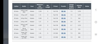

Found this on alliants webpage. Have to search by powder.
