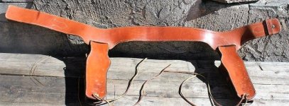

That's a pic of a ship in a bottle, John :-). How did Bedell get his holster get onto the belt when the cuff is now stitched to the fender?!

Red, it appears that the snap on the bottom is unsnapped, and the holster is pulled out of the cuff. Not an easy job or one you do frequently.

I didn’t try to remove the holster from the belt, but I believe Pig Hunter is spot on.
Yessir. The holster pouch will pull out of the cuff because the muzzle is not stitched to the fender -- but to then get the fender and cuff through the slot in the holster? Which suggests that Rogers sewed the cuff on after putting the fender through the slot in the belt. I've assembled many a buscadero such as the Bianchi 1890 that uses a buckled strap instead of a cuff; it's a real bear to accomplish with the shape and stiffness of the Bianchi (Ojala style) fender! But the buckled strap is then attached via slots not sewing as it appears here on the Rogers. Which is why I noticed :-).
