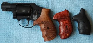

My favorite for a Centennial, after trying many, is Karl Nill's J-frame grip specifically for Centennial revolvers. Like the Hogue Centennial "Tamer," the grip goes to the top of the back strap. Most fall at least a half inch short of the full back strap (like the Altamonts on the Lady Smith in the center position in the first photo).
Spend a little money, keep trying till you find the grips that work for you.
