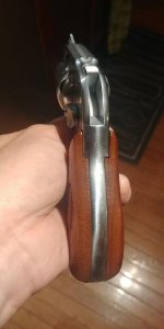

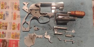

Hope someone can help.... I have Model 49 I bought on GunBroker a while ago. It has a beautiful nickel finish, seller said it was original. But on the box under FIN is lists a "B" which I'm thinking means
blued. Does that mean it was originally blue and nickel plated at the factory, or have I been fooled? Any comments would be appreciated, thank you.

Does the serial number on the box match the gun? If it's an older one, do you have a gray or blue box? Nickel guns used to ship in the gray one.
Next, is the ejector star blued? That's how S&W does it on a factory nickel job. Next, remove the grip panels and look for a capital "N" stamped underneath. If your gun is old enough, an "N" may appear on the cylinder, also.
If you aren't sure about the markings under the grip panel, post some photos of that area. There are quite a few experts here to help pick out what's pertinent and what's not. Some photos of the rest of the gun can help determine if it's a refinish, too.
Thank you for the quick reply. Yes, the serial number on the gun matches the one on the box, and the box is blue. I'm going to try to send some pics, I'm new at this, not sure if it will work......
Model 49 pics....
Think they're attached...

Nice looking 49!
A few more pictures may help the pros here (I'm not one, but do appreciate a nice 49 when I see it). Some shots of the markings will tell us a lot. Also, the end label....
I've got a couple of them and would like to find a nickel one.
JG, that looks just like a 649, the stainless version. If it's not, then it's possibly an aftermarket hard chrome finish, such as Armoloy or Metaloy. Definitely not factory nickel, though.
I agree with this ^. Open the cylinder and see if there's a model number stamped on the frame where the yoke rests when closed. That should tell you at least what it should be-of course we all know sometimes the factory mis-stamped revolvers lol.
I believe the silver boxes went away in the mid/late 70s but don't hold me to that. I had a 1978 66-1 that shipped in a blue box, came with the original box.
Thank you everybody for your opinions. Gun is very clearly stamped as a Model 49, not a 649. I'm attaching a picture of the box label, also. Serial number on box matches the one on the gun. Guess I'll never know for sure. :) JG

I agree that it looks like it could be a 649.
That little inventory sticker A25-2405 on the box label is the same size and format as my John Jovino custom guns.
KO
Then I'm going to say it's an aftermarket finish. It sure ain't blued. Still a nice little gun, though! I'd buy one like that - I had several guns Armoloyed back in the late 70s-early 80s. It was kind of a "poor man's stainless" when the real ones were sometimes hard to get.
