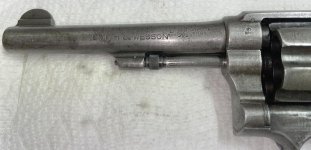

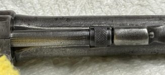

I finally had some time to look at this British model again. I did do a quick check on any power residue, etc. in the chamber and especially in the groove of the chamber stop using a dental tool and that didn’t show any leftover residue I missed cleaning the first time.
Then with a good light it appeared the chamber had a burr close to chamber stop. It was about 1/16 of the chamber radius. I cut a .375 wooden dowel and was hoping to use some 600-grit paper but sand paper was too thick.
I did try some 0000-steel wool using the wooden dowel but that didn't do a thing. I then found a sanding stone from a Dremel attachment that was .375. It was rotating true. So right or wrong. I first inserted the stone
and then turned on the Dremel at low speed just for a second. Cleaned out residue and the cartridge fit fine. I have NO idea how a burr could develop inside the chamber like that. Anyway, that was solved but now I found another problem.
With the cylinder open it revolves freely, but when
I push the ejector rod out when cylinder is turned at 180 degrees using the serial number as my Zero reference at 12 o'clock, the ejector rod starts rubbing when pushed out 3/4 inch. When I rotate ccw to 270 it binds up sooner at about 1/4 inch when I push it. Then rotate back to Zero or 12 o'clock using the serial number at my starting reference. The ejector rod easily pushes out the full length at zero and 90 degrees and the spring tension brings it back in. When it starts to bind, the spring tension isn’t enough to return it. The ejector rod will just stick out until I push it back in.
I did this test with the long rod (center pin) and spring out to make sure that wasn't what was binding. Now I'm wondering if the problem is the extractor
rod collar. You would think if the extractor rod was bent, it would bind no matter which way the cylinder was turned. Maybe I'm not looking at this right.
Anyway. Any opinions?
Once again, the timing looks good and cylinder locks up tight and would like to shoot this. But
need to figure out why extractor rod binds when it does. The cylinder turns fine in single and double action.

I hope I took the right shots. I can only post 5 pics.
I was wondering if there were shims on cylinder or crane. Almost looks like a washer at fwd cylinder face to crane, or Frame to crane too.
I did unscrew the ejector rod just 1/4 turn and NOW the ejector rod binds up at ZERO, 12 o'clock using s/n on aft cyl face as zero ref. Tighten back down, just fine.
I have a LOT to learn when I look at used revolvers. Had I seen this at a gun show I wouldn't have bought it but bought it came from a relative and the money was going for a head stone so it was for a good cause, basically a donation. It was in their father's collection, my uncle and still had a tie on it so he had never messed with it.
I would still like to know if this is safe to shoot. The cylinder gap to barrel looks good @ around
.005-.006
