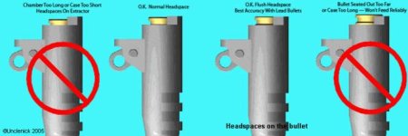

I was going thru the reloading forum a while back, ok along time ago, and some one posted a picture of how to tell if your seating depth is correct. Would like to see that picture and maybe copy . The picture showed a bullet dropped into the barrel and you could tell if it was hitting the lands or not. If anyone remembers this post. let me know..
Was this the drawing illustrating the "plunk" test for 1911 autoloaders? If it is, PM me and I'll e-mail you a copy. Please note that just because a round passes the "plunk" test, it is not guaranteed to feed reliably in an autoloader. That test merely guarantees that the round fits the chamber correctly.

I need the picture of the "plunk" test. I know that it is not guaranteed to feed reliably but I just can't explain it to my friend. my email address is [email protected]

Is this what you're looking for?

I'm surprised that so many experienced people do not understand what the numbers in the load data (not "recipe") are for. They are there merely to set the conditions under which the load data was developed. Currently, much if not most data is not even developed in a real firearm but rather in a special fixture with test barrels. They do not a guarantee that a round loaded to the listed dimensions will feed or function in your gun. In some cases, the COAL is the SAAMI maximum length. Other times, it is the length with that particular bullet crimped in the crimping groove (for cast bullets) or cannelure (jacketed bullets) for revolvers and moderate to heavy kicking auto rifles or any rifle which feeds from a tubular magazine. In autoloading pistols and bolt action rifles, the correct OAL is almost always the longest length which will fit in the magazine correctly and feed correctly without the bullet engaging the rifling which chambered.
