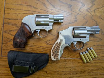

Well ever since CCW started in Texas, back in '96, I've pack guns. The first one was a S&W Centennial 640.. got it new and then had a gunsmith put on a red insert in the front sight and I did my action job... added Secret Service stocks and a IWB holster made by Gould & Goodrich (they don't make it anymore.) Still have that baby and I put on a Tyler-T and Stag grips..
Well about 4 years ago I found a 649-2 S&W Bodyguard .. pawnshop find. Added Secret Service stocks and now I have lucked into some red insert material .. yes thinking about adding a red insert to the front sight and have a pair of 'em...
Now the question.. were to get a GOOD gunsmith to add the front sight.. I want it just like my Centennial there.
Might even scare up a set of stag grips and Tyler T for it to!!!

I don't know about the Bodyguard, but my 640 has a pinned front sight, which makes it easy to replace. I put an XS regular dot on it. Very easy to see and replace.
If one can get over the ugly looking cosmetics of the Body Guard, it is IMO a better choice for SD than the Centennial. It won't get snagged on clothing while still allowing a single action shot if needed. I LIKE that option! Truthfully, I could never get over it - lol. I carried a Model 60-7 instead prior to switching over 6 years ago to a Sig P365.
I believe there was a time S&W used to offer the red insert service. Not sure if they still do? You might want to contact them.
… But since the gun is under the milling bit, ask how much more it would cost to have the whole sight milled [into a stud, per XS instructions], and install an XS [front sight onto the stud, somewhat similar to what] S&W does with the .22 Airlights and the Lipsey's ultimate carry Centennials [except their's are pinned].
