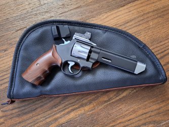

Hello all,
I have a nitron coated semi auto that i clean using mainly CLP and that's about it, no problems so far....
The revolvers however seem to get a fair bit more grubby, particularly the front of the cylinder and surrounding frame and looking at You tube etc. there is a bit of info and the "Birchwood Casey" firearm cloth gets good reviews BUT it can remove coatings....
So i'm looking for a product like that (i can get it in Australia) that will remove the burn rings and excess carbon and lead build up without potentially damaging the black finish on the SS barrel and frame? The cylinder is a matt SS and i'm concerned about polishing it as well
Any personal success shared with cleaning this gun is very much appreciated!

This is normal for shooter revolvers. The black carbon rings also bothers me so I keep my cylinders always clean if I'm not going to shoot for a while.
I don't use Birchwood cloth because it is abrasive and can eat into the finish of your gun over time. Even worse, if you keep polishing the front of your cylinder with an overly abrasive product over time you can eventually mess up the gap between the forcing cone and the cylinder front.
Instead I apply a good amount Hoppe's #9 to the front of my dirty cylinder and let it soak for 5 minutes. Then I'll use a pure copper brush (not brass), dunk it on the Hoppe's #9 bottle and brush all the burns out without damaging the stainless or blue finish of my revolvers.
Copper is a much softer metal than steel or brass and will not damage the finish of your gun.

Well now that you are a revolver owner you must reside yourself to the fact that revolver cylinders get burn rings on them - period. You can clean them fairly thoroughly with a copper brush and Hoppes #9 but you are wasting your time. Cleaning every last bit of the burn marks off is futile because the very first time you shoot 6 rounds they will return. What is important is that you clean it well enough to just keep the burn marks from getting a thickness build up. If that happens then the cylinder rotation and function can be impeded. Over cleaning the cylinder face can cause more problems that it is worth and all you want to do is clean enough to keep build up from occurring. A working revolver (once it is fired) and fired on a regular basis will always have cylinder face burn marks and as long as the revolver is not to be a "Safe Queen" that is perfectly acceptable.
I find that G96 Synthetic CLP works the best of any CLP I have tried. Break-free CLP is also a very good product but IMO the G96 synthetic does clean a little better - lubrication and rust protection qualities are the same for both. That said, the best cleaning solvent of all is Hoppes #9 which is what you can start with. After you have cleaned the face enough, use CLP for the rest of the revolver. The powder marks and soot usually wipe right off with CLP.

Thanks for the tips, much appreciated.
I did read somewhere here to be careful and check the allen head screw that holds the compensator on the front of my V-Comp....
My brand new S&W was certainly not clean and while i do understand they can't really clean every gun and it's the new owners responsibility to make sure it's ready to use.... while i was cleaning it i discovered that allen head screw loose, not even finger tight let alone secure.
So thank you for the advice to check it, can't remember where i saw it though.
It's now clean and ready for use but I have more questions now....
My bore snake got stuck in it, it's the same one i use on 2 different 9mm auto's but the 357 (which the tag says it's suitable for) wouldn't quite let it pass, it bunched up at the end and would not budge, I'm not sure why or what i should do for next time because i like making sure the bore is clean and the snake seems to do that well as a last run through
I was also wondering should i run a bore mop through it with CLP and leave it wet when i store it away? or will there be enough coating on the bore from the cleaning process?
