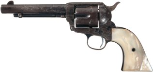

Bear in mind that colour case hardening is not a finish. It was the outcome of hardening parts when steel technology was still a baby. The luxury SAA from Colt were all blued
One that belonged to infamous Bob Dalton.
Colour case hardening IS a finish, just not an APPLIED (spray-on or plated) finish. It's like bluing in that it changes the metal surface -- but it's just a mostly-decorative "finish" that isn't very functional.
The chemical treatment being used by the original poster is similar to the traditional color case hardening, but perhaps with even less of a protective function -- it's done mostly for looks
The colored surface of a S&W slide is NOT the finish -- it's mostly a cosmetic application. The hardening process is done before THAT colored material is applied. Removing the colored surface isn't likely to affect the factory-applied case hardening (which toughens the metal surface), and the chemical "case-hardening" being used on top of that will just make it look different.
