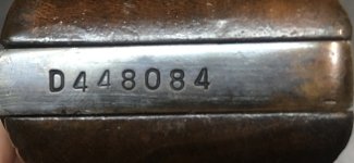

Can I ask a question about serial numbers re my Model 10-5? This is on the butt:
which I presume is the Ser. # (but not of course a registration number.)
I read somewhere that the Model 10-5 had the wider 1/8" front sight, but mine is 1/10" Maybe early in the run?
I also just checked the grips. The RH one is stamped 00886.
