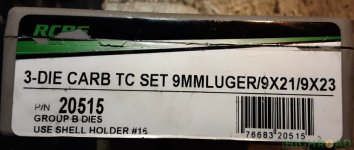

9mm dies.
New RCBS carbide sizing die has the 9mm Luger case body taper built into the die. Does 1 size fit all?
I've used my 38 S&W dies for 9mm Mak.
The set of RCBS 9mm dies I bought in 2014 are labeled: 9x19, 9x21, 9x23 mm
