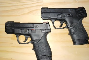

I now own three Shields
A Gen-1 3.1" 8+1 Shield I bought in 2012

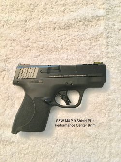

A P/C 4" Shield Plus I bought 4-5 weeks ago

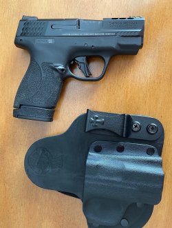

A Gen-2 3.1" 13+1 Shield plus I bought 3 weeks ago.
And when I was sighting in my original G1 Shield it shot (post Apex trigger upgrade) consistently prior to adjustment 3-4" to the left at 15 yards off sand bags and both of my new Shields also shoot 3-4" to the left at 15 yards. Not high or low just nice uniform 2.5-3" clusters at 15 yards but always 3-4" to the left. Easily corrected by drifting the front sight Right, just surprised me this was the case with all three of my Shields.
I know this was not me as I didn't experience this issue with any of my three P320's or two Walther PDP's or my one 4.25" 9mm M&P C.O.R.E.
Not a big issue what so ever and easily fixed just surprised all three of my Shields had the same accuracy POA/POI difference.
