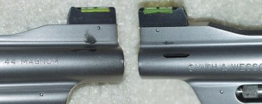

The only by-product of shooting cast in my 4" ported 44 magnum is a light
deposit of lead above the ports on sides of the front sight ramp.
Never noticed anything unusual about shooting plated bullets (at modest velocity).
