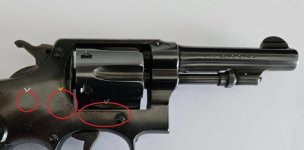

Dear forum friends, I urgently need your help because I found this apparently new 32 Hand Ejector, I have to send money immediately to stop it but I don't know the gun at all. It looks beautiful but it doesn't have the S&W mark stamped on the side, and this thing made me suspicious. Enlarging the photo the sideplate seems brushed. SN 272141
On the 4th edition of the Standard Catalog says the the small S&W trademark are present on the LH side or rare in th RH sideplate
He's an old man who's selling it and I can't ask him for more photos because he says he can't take more but has to ask his nephew if he can go to his house after work to take more photos.

Great gun!! It is a 32 Hand Ejector, 3rd Model, or Model 1903 which is an I frame revolver and smaller than the 38 Military & Police. It was made between 1917 and 1920. S&Ws were made without stamped logos during the WWI timeframe. The gun chambers 32 Long cartridge.
So you assure me that the revolver is correct without any S&W trademark stamped on it...
If so i'll be very happy to buy it

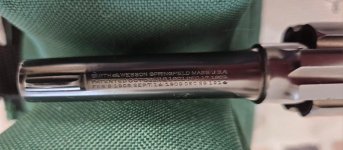

Mine has a definite S&W logo on the left side. However, mine was made circa 1910 and this is something that I've read changed thru the years (no expert). I will say that the finish in the photos looks exceptional for a gun of that vintage. It is hard to tell, but it looks like the word "Wesson" on the barrel is much more shallow than "Smith", making me believe it MIGHT have been polished and refinished. It may just be the lighting. There is hardly any cylinder line, so it hasn't been used much since the finish was applied, whether original or refinish. It's a good-looking gun, and most definitely is a S&W.

As I said I can't have more photos, I have to make do with what I have to understand if the gun is in original condition or if it has been reblued. Ultimately I read your answers I don't understand if the lack of trademark is correct for that serial number. Only glowe claims that during the war period no marks were placed on Smith & Wesson guns, but then he says, there is no doubt that it is a S&W. of course it is a S&W, I never doubted it, but that was not what I wanted to know. In the first photo, the one with the box, you can clearly see that the gun is in excellent condition, it would seem original, it has all the lines, planes and edges perfect, even on the cylinder. Since I can't have more photos I can't see the knurled end of the ejector rod well but by enlarging the photo a lot it would seem with the face that engages the locking not reblued and the rolled writing on the barrel seems perfect to me. Instead the side plate would seem brushed but not with the altered plane. To erase the trademark they would have had to work hard as it was deeply engraved. In any case, the highlighted position is not the one in which the trademarks must be.
If it was factory reblued should it have stamps under the grips certifying this?
In the photo posted on the next thread, which I borrowed, you can clearly see the sideplate perfectly following the plane of the frame and the perfect surface.
in the third photo where there is the white tick you can see a circular shadow that could make you think of the presence of the S&W stamp, where there is the yellow tick you can see some signs of workmanship and a rust stain, in the green tick you can see the sideplate that does not follow the frame
also in the photos of the previous thread the barrel has rolled the caliber engraving on the left side in the revolver in question is on the right side

I was prepared to say it had been reblued from the first look. Seeing the last photo, I am convinced it is not the original finish. The finish looks a bit blacker that factory to me and I looked closely at the ejector rod knob and it is blued. Not a bad little gun if the price is right. The box may be worth as much as the gun, I don't know.

This thread started with a major question about the LACK OF the small S&W logo on the left side under the cylinder latch. Mine also has it. However I did just check the latest edition of SCSW, the 5th edition, page 177, and I quote "Some early examples were void of the S&W trademark on the frame.
From the description in SCSW 5th AND the OP's serial number of 272141, the gun in question is undoubtably a .32 Hand Ejector Third Model, manufactured from 1919 to 1942 and with serial numbers from 263001 to 536684. The OP's gun is clearly a "early" serial number (272141)....so.....all correct......except appears to have been re-finished.

WHOA.... Hold the presses Marcello...may NOT be refinished!
I did some more thinking (I know dangerous at my age) and then I got my 32 Hand Ejector out and started comparing with Marcellos' photos sent to him by the Seller.
1st comparison: the factory bluing on his vs mine. Mine is well worn but in less worn areas the blue is definitely "blacker" than bluer, and appears real nice and rich under some light.
2nd comparison (and the real kicker to me), I enlarged one of his pics, the one with the white and green tick marks, the same areas on mine look the same or very similar BUT in enlarging his pic please notice the very "tip" of his ejector rod knob. It sure appears "in the white" to me!
I shot some quick cell phone pics of mine trying for the same basic angle and they also appear the same, so with my cylinder open sure you can see the in the white tip, but what about the one Marcello is looking at?
If not too late maybe you can ask the Seller to just open the cylinder and see what the LERK tip looks like.
That was the only thing making me believe it was refinished and now I'm thinking maybe you have found an all correct gun with the box.:D

I stand by my comments, this is an original blued S&W. I see nothing in the photos that lead me to believe it is redone. The stamp on the barrel flat is not a refinish mark, but rather an Italian proof mark. I think you are overanalyzing this gun's condition. It is a great 32 HE and does not have a LERK!!!!!!!! The lack of a logo is found on every S&W made between 1917 and 1920, so this one is legit. No way anyone could take off that much metal on the sideplate to eliminate the logo that would not be very obvious.
