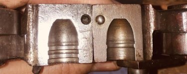

I just stumbled onto this today. I've been researching the Schofield for a while now...On and off.... Been convinced that there was actually an earlier bullet design that was similar to the earlier 44 American/Russian bullet and in fact the early 32 and 38 Smith & Wesson rounds as well.
This Ideal field loader that is Pre-1887 by configuration has exactly what I was looking for. So few Schofield revolvers were manufactured as compared to the 32's, 38's, and 44's making it very difficult to locate this early bullet. See photo 1.
Photo 2 would represent the typical Post 1887 bullet.
I was wondering if anyone else has one of the early Ideal loaders in 45 S&W in their collection? When found typically it is the Post 1902 variation loader with the later and typical bullet design in photo 2.
So, basically Photo 1 would have been the standard bullet from 1875 until 1887 at which point the improved bullets were introduced to the full line of Smith & Wesson revolvers.
You can also see from the additional photo's the early 44 bullet design is basically the same as the early Schofield bullet design. Having a single lube groove with no crimp representing the early "outside lubricated" bullet.
I have also never actually seen an early original cartridge. Every one that I have seen is the typical Post 1887 multi-lube groove bullet. This is very hard to find information. Even harder to confirm. Just thought I'd share.

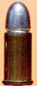

The Ideal Field loader/mold arrived and I performed a comparison between the later inside lubricated (IL) multi-groove bullet shown in the photo on the left with the earlier outside lubricated (OL) bullet on the right from an also earlier Ideal field loader that dates to Pre-1887 by design.
To me right away you can see the similarities between the two. However, when I take a caliber to them there is absolutely nothing the same about them.
The earlier OL bullet depicts a .451 diameter bullet while the later IL bullet depicts a .456 diameter bullet... Basically, that proves that the IL later bullet could not have been made into an OL earlier bullet unless you can somehow make a bigger hole smaller with a boring bid?
Also, the overall length of the bullets are different. The earlier bullet is shorter by .006 and the lubrication groove is also smaller with the earlier bullet.
I realize that this is not much of a survey but these molds are near impossible to locate. Even the later IL 45 Schofield bullet mold/field loader is very difficult to find.
This only supports that there was in fact an earlier bullet. It also supports that the bore of the early guns might have been different than the standard .454 found on the later bullet/bore design.

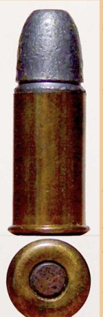

Photos of early bullets
Once the Schofield went to surplus and was purchased by the general public, Wells Fargo, American Express, etc., they would have been then loaded with Commercially manufactured ammunition and reloaded with tools that loaded the typical outside lubricated bullet. Also, early tool kits did not apply a case crimp until 1887. However, Commercially manufactured rounds were often crimped.
See photos of early 44 American and 44 Russian type OL bullets and the 1878 32 S&W OL round with S&W early 1878 ad showing the early Bullet with and without a case crimp.

It has always been my understanding that outside lubricated bullets are of the heeled variety, as seen in the 22 Long Rifle. These have the bullet larger diameter the same as the OD of the case.
Inside lubricated bullets are the diameter of the ID of the case, whether or not all the lube grooves are actually inside the case.
The transition from outside lubed to inside lubed saw 44's become 43's and 38's become 35's as some examples.
Outside lubricated
Reloadforfun,
That's an outstanding point you bring up. Smith & Wesson early OL bullets were not like others of that ERA in that they were not manufactured as the same Outside diameter of the cartridge case.
They were outside lubricated bullets but the same diameter as the " Inside" of the case. Very unique. Inside lubricated requires that the lubricant be within and protected inside lubrication grooves inside the case.
