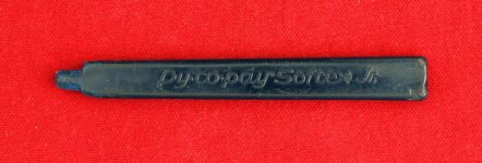

Second Thoughts
Make something like this, out fo an old toothbrush handle, to avoid this on your floorplate when you disassemble the gun.
