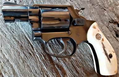

Naturally I can't speak to anything bigger than a J-frame. The first known 2" Chiefs Special marked MOD-36 is serial number 126017, and it shipped September 4, 1958.
Since you mentioned the model mark and assembly number, it is also the only model-marked revolver I've seen or heard of with the two numbers stamped together.

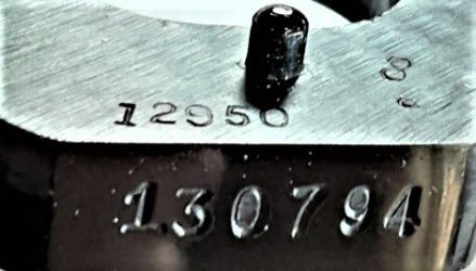

I also have Chiefs Special Airweight serial number 130794, which shipped in August 1958: it is not model marked, and its assembly number is in the new location on the lower left side of the grip frame.

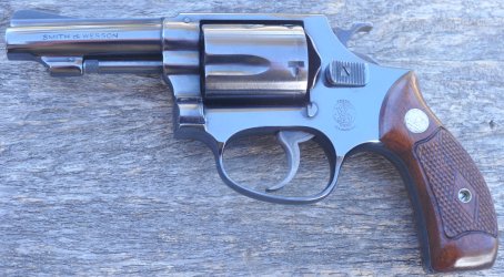

Here, also, is the first known 3" Chiefs Special with a model stamp. It shipped on October 20, 1958.
Wow, thanks for that. That over-stamp likely means the administration put their foot down and said "stamp those damn things anyway, nobody looks at this stuff!"
