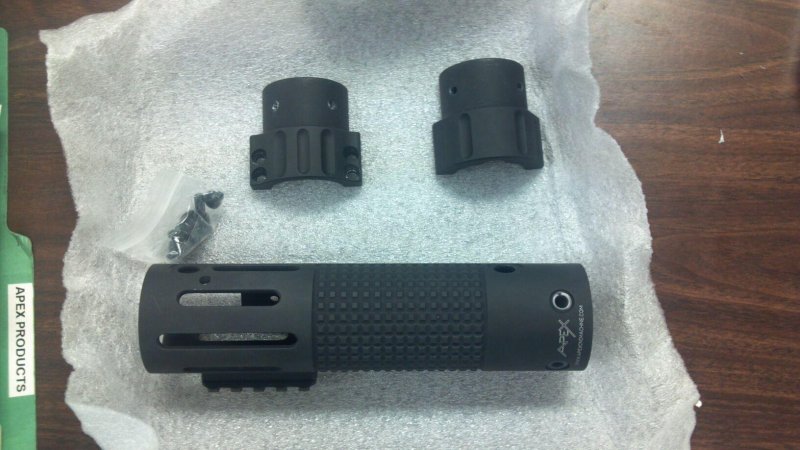

Got the handguard in the mail from Apex today and wasted no time getting to work. I got the front sight tape pins out without too much happering, but getting the delta ring off was another matter altogether.
The combo wrench I bought off eBay was pretty much useless except for removing the flash hider. The 1/2" socket hole was undersized so my torque wrench could not fit it. And to make matter worse, the pins on the barrel wrench are improperly spaced so that it's impossible to maintain firm contact with the barrel nut. In fact, it's slipped bad enough to deform the teeth in the barrel nut.
So with all these obstacles facing me I did the next best thing. I went to the hardware store and bought a pack of reinforced cutoff wheels for my Dremel and cut off the delta ring, spring and retainer clip. :D
But before I installed the gas tube I took a round file and cleaned up the barrel nut teeth that the wrench borked.
And the results of my effort...
Mounting is via a clamp that fits over the stock barrel nut, then the guard screws onto the clamp.
It's an extended carbine length so there's a cutout in the top to accommodate my stock front sight gas block
Rails can be mounted to any of the slots (it came with one 2" rail mounted on the side which I moved to the bottom for when I want to mount a bipod). It also has four QD sling mount points.
Bill that is absolutely gorgeous. That has that "business but not in your face" look. IMHO they should build a model like that that looks comfortable to carry especially with the swivel attachments able to move to the side. A sling always felt more comfortable when one end was turned sideways and the carry better. That handgrip area looks cool is it comfortable and does it give you a steady hold. Like it.
Grover, the checkering (Apex calls it their Gator Grip) does provide a very positive hold. without getting uncomfortable.
Now that I've free floated my barrel I guess I can use a sling during offhand shooting and not worry about it affecting my accuracy. :)
I really like that a lot. If you put a sling on it and sling up real tight though, will it flex and push up against the front sight?
Not sure.There's about 1/8" clearance to either side of the front sight. When I finally get a sling I'll let you know.
