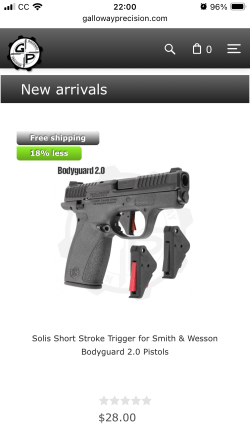

I measured the trigger and it does break at 4 lbs, give or take. I'm going to see what Galloway has to offer. I changed the trigger on my LCP Max and the hammer spring with Galloway's offerings. Changed triggers to Apex on all three M&Ps. Never cared for the hinged triggers.
Eric at Galloway told me by way of e-mail on August 15 that they will have a stronger striker spring that should be out by year end. He said they will offer it mainly to make primer strike more positive. He add that the new spring should add 1.5 to 2 lbs to the trigger pull.
Same e-mail said they are working with the spring maker on several projects. So, like many things, it is said to be in the works.
PS: I do not do Facebook or instagram etc... how do they announce new offerings?
You can subscribe to their site via email to get their announcements.
